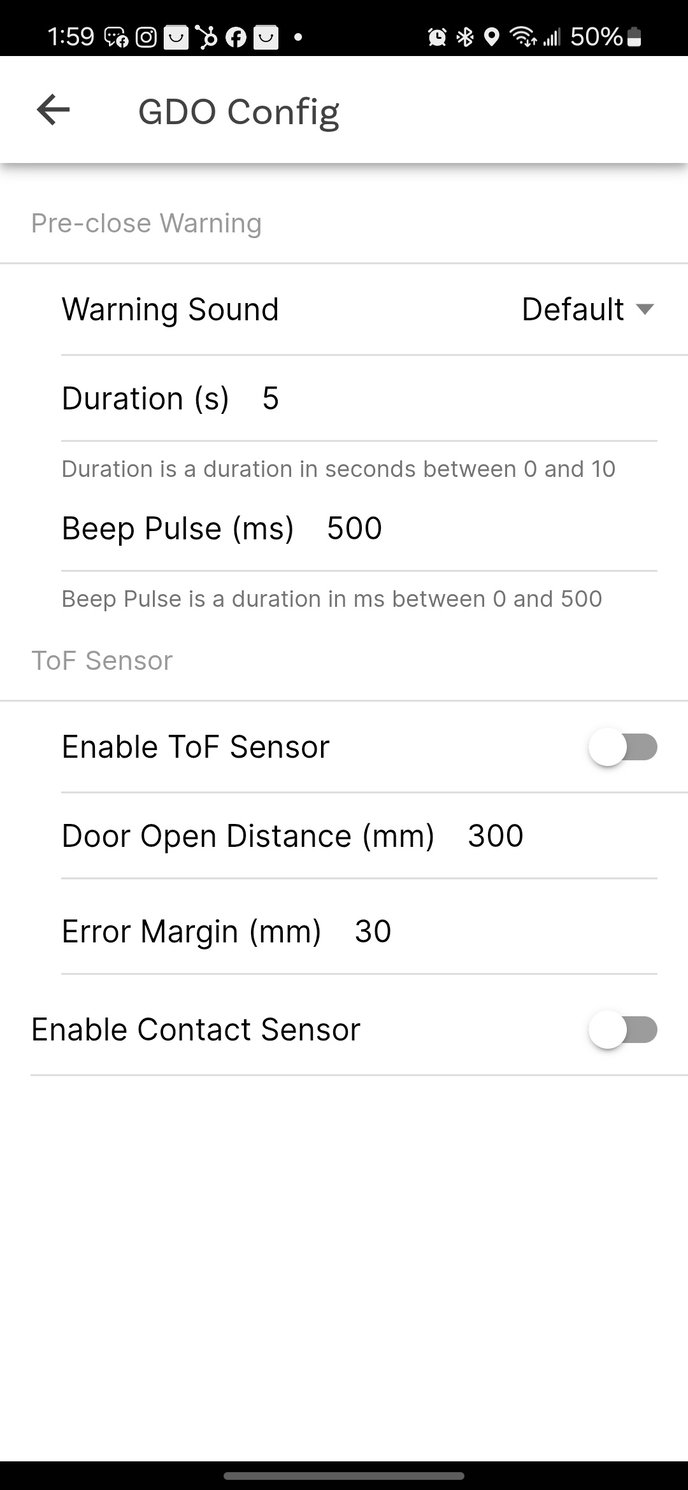

After the GDO White is commissioned into a Matter controller, use the Konnected app to calibrate the optical sensor and optionally enable other options. The Konnected app uses BLE (Bluetooth) to configure the Matter-enabled GDO White, so ensure that you're standing near the GDO White when doing these steps.
You need to be accepted into Konnected's Matter EAP program, and your Konnected account enabled for Matter (beta) access. Apply to join the Konnected Matter EAP.
Screenshot_20250130_135742_Konnected (2)Tap Matter (Beta) on the Konnected app menu to access the Matter device tool. It will automatically start scanning for Matter-enabled Konnected devices via Bluetooth.
When your device is found, tap the device card.
The default pairing code is 1-2-3-4-5-6
A popup will ask you for a Bluetooth device pairing code. Enter the default code 1-2-3-4-5-6 to continue.
Once paired, tap Configure GDO Settings to set up the features of your GDO White.
Screenshot_20250130_135946_Konnected (1)Pre-close Warning
Here you can change the sound and duration of the pre-closing warning. The default and minimum warning duration is 5 seconds.
ToF Sensor
Enables the optical laser sensor to detect if the garage is open. Currently, this requires manual calibration. Enter the Door Open Distance (in millimeters) measured by the optical laser sensor from the ceiling to the top of the garage door when it's open.
Contact Sensor
Optionally enable a wired sensor connected to the INPUT terminals to detect the state of the garage door.
Device Settings
Tap Device Settings to change the Bluetooth pairing PIN and set a password for Over-the-Air updates.
