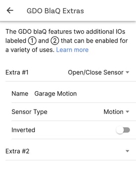

1. *![Screenshot\_20250926\_210619\_Konnected](https://support.konnected.io/hs-fs/hubfs/Screenshot_20250926_210619_Konnected.jpg?width=274&height=353&name=Screenshot_20250926_210619_Konnected.jpg)*From *My Devices*, tap on your GDO blaQ and tap *Settings \> Extra Input / Output*
2. Tap on *Extra #1* or *Extra #2* and select *Open/Close Sensor*
3. Set the *Name* and *Sensor Type*. This determines how the extra sensor will appear in your smart home app.
4. Check the *Inverted* option to invert the open/closed logic if needed.
