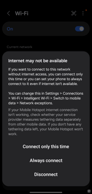

  7. Be sure to Allow any app permissions and Accept any warnings about no internet access.

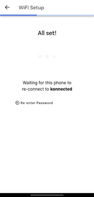

  8. If successful, the konnected-xxxxxx setup network will disappear and your phone should automatically reconnect to your WiFi network and you can continue with device discovery.

  • If you don't get past the All Set screen, make sure that your phone reconnects to the same WiFi network that you just set up on the Konnected device.
  • If the konnected-xxxxxx setup network is still visible, then the device failed to connect to your WiFi. Try re-entering the password, or try the captive portal method.
