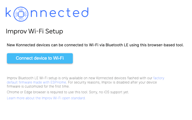

  1. Open a Chrome or Edge web browser on a Windows laptop, Chromebook, or Android device to https://install.konnected.io/wifi. Note: This method will not work on iOS devices or Mac computers at this time.
  2. Click on the Connect device to Wi-Fi button.

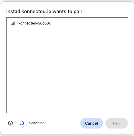

  3. Select the Konnected device from the pairing pop-up.

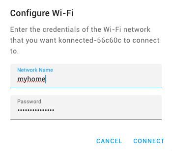

  4. Enter your home WiFi SSID and password.
