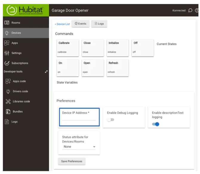

- Fill in a Device Name. The Device Network ID should be auto-populated for you. Select Konnected Garage Door GDOv2-Q from the Type drop-down. It will appear at the bottom of the drop-down under the User heading.
- Find the IP address of the device on your local network. You can find this in the Konnected app, or by looking in your router's app for a device named garage-door-XXXXX or konnected-XXXXXX. Enter the IP address in the device's Preferences section and Save Preferences.
- After saving the IP Address, Hubitat will connect to your device and automatically populate states! Your Garage Door Opener is now ready to install and use.
