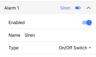

After the panel is armed, these configured functions run on the panel:
- Monitoring wired zones connected to that panel.
- Applying each zone's trigger mode and armed-mode bypass settings.
- Applying entry, exit, and arming delays.
- Activating a connected siren, strobe, buzzer, or other configured alarm response.
- Turning off the alarm response when the system is disarmed or cleared.

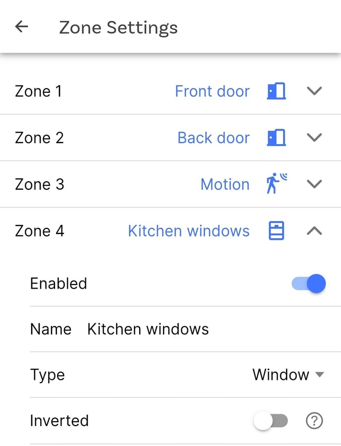

### Before you begin
1. Install the current Konnected ESPHome firmware supported by your device.
2. Add the device to the **Konnected Mobile App** and sign in to your Konnected Cloud account. The account is required to use Konnected's firmware configuration service.
3. In the app, open the device and tap **Settings**.
4. Configure your input and output zones before enabling Standalone Alarm System.
