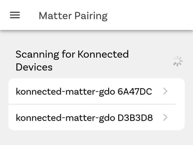

Screenshot_20250130_135742_Konnected (2)Tap Matter (Beta) on the Konnected app menu to access the Matter device tool. It will automatically start scanning for Matter-enabled Konnected devices via Bluetooth.
When your device is found, tap the device card.
The default pairing code is 1-2-3-4-5-6
A popup will ask you for a Bluetooth device pairing code. Enter the default code 1-2-3-4-5-6 to continue.

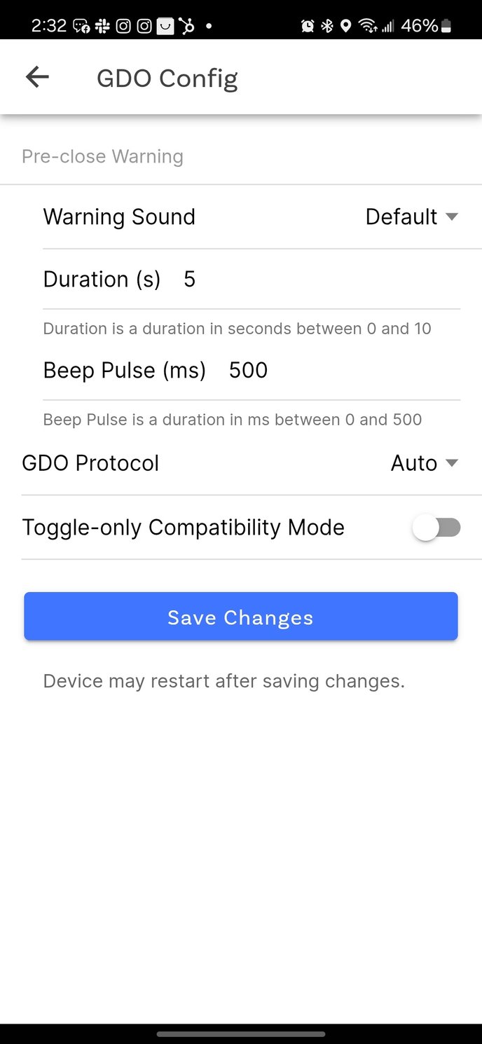

Once paired, tap Configure GDO Settings to set up the features of your GDO blaQ.
Screenshot_20250130_143240_KonnectedPre-close Warning
You can change the sound and duration of the pre-closing warning. The default and minimum warning duration is 5 seconds.
GDO Protocol
Set the GDO Protocol manually if necessary. Auto should work in most cases. Choose Security+2.0 for openers with a round yellow learn button. For Security+1.0 openers (purple or red) learn button, if you have a digital wall button (usually includes a motion sensor), then choose Security+1.0 with smart panel otherwise, choose Security+1.0.
Toggle-only Compatibility Mode
Enable this option if the GDO blaQ cannot close the garage door. This is normally only needed on certain models of garage openers in Australia or New Zealand that lack IR safety beam (obstruction) sensors.
