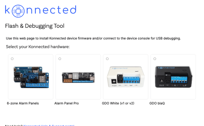

Use the Konnected Flash Tool from your web browser
The easiest way to flash is using our web-based Flash Tool at install.konnected.io to quickly and automatically flash your device with the latest Konnected firmware for your product. Use Chrome or Edge browser (does not work in Safari!).
- Go to install.konnected.io
- Select your product
- Select your desired firmware platform
- Select a build option (if available) and click CONNECT
- Plug in your device and select the USB serial port. On Windows this shows up as COM3 or COM4 or similar. On Mac it will show up as cu.usbserial or cu.usbmodem.
- Click Install [productname] to begin the installlation.
