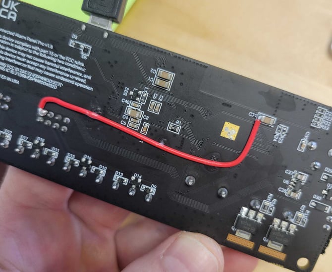

    Exposed patch wire on back of board
    Affected version: Alarm Panel Pro v1.8, batch 2301
    All boards in batch 2301 have an exposed red wire soldered and affixed to the back of the board. This wire is necessary for the device to function, and was added by our manufacturer to mitigate a manufacturing defect internal to the board. Do not remove or disturb this wire. These devices are fully functional, and this defect is considered cosmetic.
    20230413_103054
