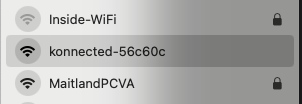

  2. Connect your computer or mobile device to the konnected-xxxxxx WiFi setup network broadcast by the device.

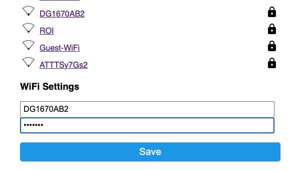

  4. Find your WiFi network and click it, or manually enter your WiFi SSID and password in the fields below.
    Screenshot 2025-09-23 at 9.19.22 AM
  5. Click or tap Save to send the WiFi credentials to the device.
